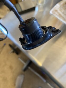

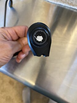

Here are photos of the piece I'm talking about. I used some penetrating oil, but it's still stuck. I'm thinking I may need to break the button holder to get it off.

CXRAndy
Lincs
It looks threaded into the broken top plate.
If it's super tight and won't undo.
Id use either a Dremel or small junior hack saw. Carefully cut a slot through the top mount plate. This will release the tightness

That's a good idea. Hoping not to have to do surgery, but I don't see a choice. Thanks for the idea!
