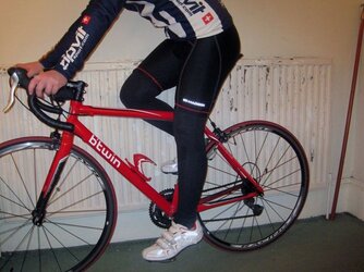

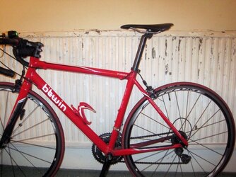

Take a photo of your bike and also one of you sitting on it, maybe a video of you cycling too - someone might be able to spot if the position looks a bit off (probably best posting a new thread for this so more people will read it)

Take a photo of your bike and also one of you sitting on it someone might be able to spot if the position looks a bit off

I'll get some pics in a moment, not sure I want to visit my doctor. I'll give it a few more days and see what happens.

These any good?

Gravity Aided
Land of Lincoln
Looks like maybe lowering the seatpost will also lower your center of gravity and help you with your unfortunate circumstance, making things better all the ways around. Your heel should be able to touch the pedal with a slight bend in your leg at the bottom of the stroke. It looks to me from the first picture that you are having trouble reaching the bottom of the stroke with your toes, indicating your seatpost may be too high .This may be causing you to slide back and forth across the saddle, perhaps causing your problems. Other may have other views on this matter. Bikefit can be as divisive as American politics.
