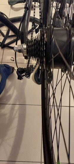

Ok got the wheel back on nice and straight, lined up disc brake. Only eyeballed straightening the dropout hanger but gonna clean up the chain and derailleur before putting them back on so no idea how it will be. Lot straighter than it was so thanks you guys. Of it's not great I'll buy a new one and get someone properly align it.
Im glad.
Good idea to get a new one anyway; the old one will have been weakened by the original bash it got, and by the straightening out.

If anyone was wondering the wheel wouldn't come out as the axle had slightly twisted, well not twisted but turned in the dropout, so I just needed to take a nut off and use a spanner on the two flat bits of the axle to pull it back round. It took no effort at all considering how much the damn thing seemed stuck in there.
Get the hanger as straight (vertical) as possible by eye (better by other means - search on here) before refitting the RD.
If it was bent much then as said, procure a new one and replace at an early opportunity.
