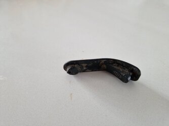

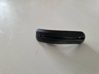

It seems the "plate" is actually only held in by press fit. I just found it on the ground behind my car, where it must have fallen out as I was putting the bike on the car after pulling the old cable.
This is it

Yup, press fit and cable pressure keeps it in place…….im guessing they never used a piece of clear tube to put the cable through and just let it sit there to rub away at the plastic
