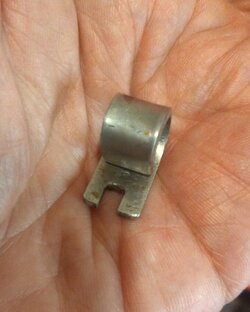

I couldn't find a tool one evening, so made my own.
