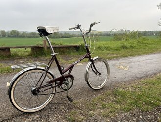

Went to pick up the ‘I didn’t mean to buy it’ Kingpin today. What colour is it? Burgundy? Brown? Anyway it rides ok, the brakes work and it stops, eventually, the gears are stuck in 3rd ATM, but that’ll be ok. Saddle is in good condition, but lost its badge, not sure if it a Mertens, Middlemores or a Brooks, I think it’s the latter but not certain. There’s a bit of rust which I’m sure I can sort out. Chain guard is really tatty, that’ll need work. The year 5/80 on the hub. I’m rather taken by the front rack and the D shaped light bracket. Not bad for 18 sovs.
Looks a bit crusty in parts, guessing it's been stored outside for some of its life, and may account for gear change problem.

This week I fettled the Sturmey Archer 3 speed hub. It was stuck in third gear and wouldn’t budge, I removed the wheel, and could only get the toggle to move with a pair of pliers.
I poured some degreaser down the axle and it started to move and change gear, but obviously I couldn’t leave it like that, so I took the whole thing apart, left the parts soaking overnight in diluted ScrewFix degreaser solution.
Next day I cleaned all the parts digging out old thick congealed gunk, dirt etc., with a toothbrush and rinsed and let it all dry off.
I was feeling confident about putting it all back together, I’ve done a few of these now, but I still referred to RJ The Bike Guy’s video to jog my memory on a couple of things, like which way round the pawl spring goes. ( remarkably I dropped the effing thing twice on the floor, but managed to find it!).
It probably took me about 90 minutes to reassemble the gears, including getting the sprocket circlip back on ( feckin awkward thing) then realising I'd forgotten to put on the sprocket dust cap, and had to take off the circlip, the sprocket, the washers again, then put it all back on.
Once the wheel was back on I took the bike for a quick test ride, including going up a small hill, the gears now work perfectly.
I really enjoy taking apart and servicing these gears, I am in awe of how they even came up with the design in the first place. It’s utter genius.
I‘m not sure what I’m going to do with this bike ultimately, but what ever I do the gears needed sorting one way or the other.
