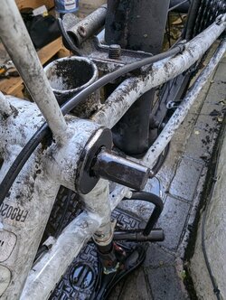

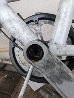

Hello,
I'm currently trying to remove the crankset from my bike and simply I can't, I've watched tons of videos on yt and I can't find a tutorial for my crankset. I will attach two pictures and also on the pedal I found what I suppose is the model which is FC-GSP312. I already removed both bolts on the pedal but other than that I'm not sure how to proceed.
Could anyone guide me with how to do it and what tools I need?
Thank you so much!

https://sl.bing.net/etYiIRnr1hs This image should show you a cycle crank remover which when you get one should pull the cranks off with the help of a good adjustable.
silva
Belgium
Be careful it's easy to ruin the alu thread inside the crank.
The left pic shows a burr, indicating damage at the beginning.
Cheaper tools have less precise thread - more play, causing the force to concentrate on 1 or 2 instead of all threads simultaneously, ruining those, and in a succession, the others.

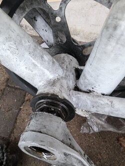

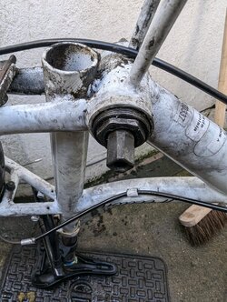

So, I've got the tool and I managed to take the pedals out. Now I want to take the bottom bracket out and give it a good clean. How do o do that and what tools do I need?
Thank you so much!

You'll need a big spanner for the first picture and something large enough to get across the flats on the second picture. The video above covers both. It is worth being ready for loose ball bearings to behave like you've just opened the door at a cattery - they will disappear in all directions and you'll never find them all. If you're lucky, the bearings will be caged (as in the video).
But really, watch the video.
T4tomo
Whats the end game here? i.e. have you got a new BB and crankset to install? In which case you might not care if Ball bearings cover the floor.
PS wash the bike, its giving me the creeps. ^_^
