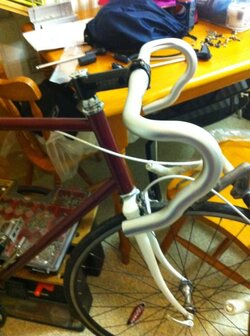

You can either get a stem adaptor which you then attach a modern stem to, iirc you can get them from Decathlon. Or it is possible to put a modern headset on an old frame, but you will need new forks rather than threaded and you will need to make sure there is enough length on the steerer. TBH though if I did a restoration of a quality frame I would use a quill stem they look good. You can still get quil stems. Planet X always have discounted ones.
I saw them at Decathlon too, a few months back - about five or six quid so by far the cheapest new.

Using a stem adaptor means that you retain the traditional headset and headset adjustment. The adaptor is basically like the down section of a quill. It fits the same way, with an expander or wedge bolt. Visually, the giveaways are the headset stack and, if your stem isn't right down low, an spindly-looking section of adaptor (much thinner than steerer tube with spacers).

Am sure it's not for everyone
But I think it's turned out well so far using the adaptor
Got a get of new levers on the way to finish off the modern cockpit
