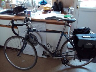

I like my quill stem much more adjustable and a good one should not flex. They do tend to creek when they get older however.
