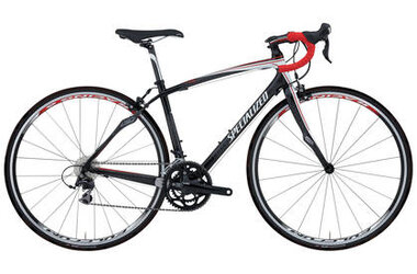

Don't take this the wrong way, but what about a ladies fit? Some of them you would be hard pressed to tell the difference just looking at them. Just that they come in smaller sizes and shorter geometry which may well suit.
My Specialized Ruby only has a slightly sloping bar which you could hardly tell the difference.
