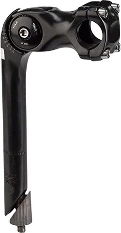

Once the bars are angled back more, rotation makes a bigger difference in effective wrist angle, and getting it right becomes more important. I would try different rotational positions on your angled bars before giving up on them. Pointing down slightly worked best for me to relieve a tendency towards numbness. It looks like you could get a bit of height difference with that adjustable-angle stem, too, but they will affect each other with regard to the resulting wrist angle. Deviating too much from flat bars on a suspension fork might not be a good idea on bumpy trails, however, dunno.
I haven't tried any bolt-on grips that give a bullhorn-like hand position, and I hadn't tried my Ergon grips for long before I tried a butterfly bar instead. It has solved the single grip position problem handily.
CharleyFarley
Japan
