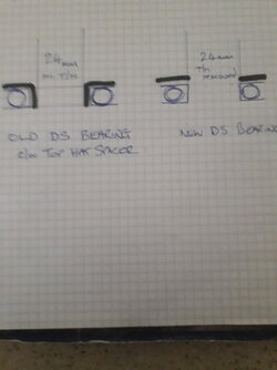

I've now replaced the bearings
The old DS bearings had as fossyant said a plastic top hot acting as spacer
The internal diameter of the bearing was 24mm INCLUDING the top hat sleeve
Tbe new DS bearing had an internal diameter of 24mm so to get the use of a spacer via the top hat I had to cut away the top hat sleeve which left the flange part acting as the spacer
Maybe I did this incorrect ?
My concern now is
Will the cranks be butting up against the spacer/bb cups and not spinning freely ??
In the original with top hat inside the bearing and snug with the spindle this would mean the whole top hat would spin with the bearing smoothly in co heshion with the axle
I'm not to sure this would be the case now
It seems to spin free enough with no obvious friction ...the cranks do stop spinning after maybe 5 revolution on there own
