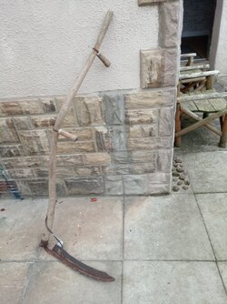

Does anyone have any experience with sharpening a scythe , just acquired one and want to put it to use , lots of info on YouTube, but the main issue is whether to peen ( hammer the blade edge flatter) or not , apparently American style blades shouldn't be peened but European ones should , if so not sure my knowledge of metals would be up to it . Done lots of sharpening of other garden tools but none that involved a hammer.

we always sharpened ours with a sharpening stone. i wouldnt peen it.

My Grandfather used a scythe to cut grass back in the 1950s he was head gardener at RAF Hullavington. He would take me to work on the aerodrome and I would watch him cut the grass with a scythe. He would stop frequently and sharpen the scythe with a stone which was about the size of a cucumber. The scythe was extremely sharp and it was kept in sacking. There is a knack to using the scythe. Happy days.

Always used a sharpening stone and only experience will make you good at it. I used them in the sixties mostly for mowing thistles and nettles which are a lot easier than grass to cut. I’m pleased I have a strimmer now 😀

I have used one a bit and they're a lot less back-braking than a sickle to use for more than 5 minutes. Never sharpened one but have sharpened bill-hooks and sickles. A fairly fine cigar shaped oilstone is probably the best. Lots of the ones I see on the 'bay look a bit on the coarse side. I have a 3" diameter round flat stone (double sided / course-fine) but that's really for an axe rather than a concave curved blade but would likely still be OK for a scythe if not a sickle

I was a bit surprised at the suggestion of hammering a blade to sharpen it, perhaps someone very experienced in using and sharpening sythes but filling and wet stone or oil stone would be something I'd be more comfortable with
