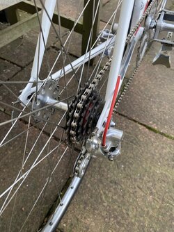

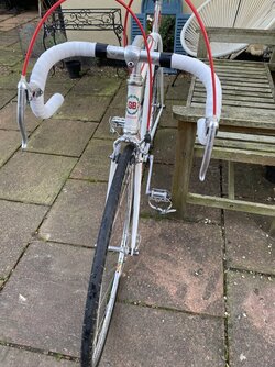

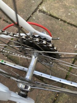

The rear wheel will have a freewheel and not a cassette. If you want to change it the way they work are different needing different tools and kit. Just out of curiosity does the skewer have a straight and not curved lever?
Skewer is curved.

Curved skewer, held with circlip, round holes = Campag Nuovo Tipo hubs with freewheel. Nice :smile:

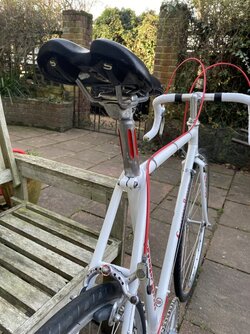

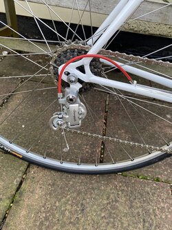

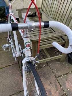

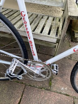

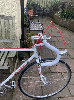

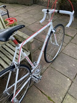

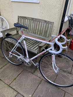

Well it’s finally finished. Christmas break allowed me to get the old girl back together after all this time.
It’s a very nice ride as well as looking pretty good - if I say so myself!!

That's a beaut . Hope you've got plenty of replacement bar tapes as that will get dirty very quickly.
