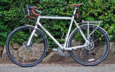

OK. All the things I'd wanted to know about the Croix de Fer before buying the bike on the Cycle to work scheme......and can now answer happily from experience !
The brakes, once bedded in are great although squeal a little. The Madison Ridge Disc Pannier Rack (£24.99 from CRC) fits simply and well. This rack looks lighter than the topeak supertourist which is more costly at £31.99 from CRC. The CdF has separate eyelets for rack and guards which I've used but it did mean bending the mudguard stays around the disc brake mounting a bit. I've also switched the stock tyres which were noisy on the road to marathon 700X32s which seem much to have much less road drag and increased my enjoyment riding even more ! I've been using a rucsac since getting the bike but now I've fitted the rack, I'll be able to better compare the overall ride feel to the Tricross.
My rides so far seem to involve a bit more effort up hills than riding the Tricross. This possibly because of the smaller rear cog range and compact chainset. However, the extra effort is rewarded by extra speed (about 0.5mph more on average commute at about 14.5 mph) and a much smoother ride. I imagine it to be like driving a top of the range exec car compared to the Tricross's more boy racer GTI approach.....but then what were cars all about anyway ??
Weight of my size 60 CdF with guards and rack as pictured.....13.4kg. This compares to 12.6kg for my XL Tricross with the same tyres and guards and a rack.

... The Madison Ridge Disc Pannier Rack (£24.99 from CRC) fits simply and well. This rack looks lighter than the topeak supertourist which is more costly at £31.99 from CRC. The CdF has separate eyelets for rack and guards which I've used but it did mean bending the mudguard stays around the disc brake mounting a bit. ...

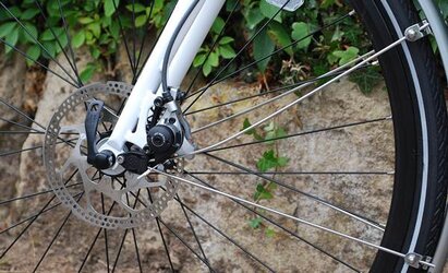

could you add a piccie of the drive train side mounting point you used?I've also switched the stock tyres which were noisy on the road to marathon 700X32s which seem much to have much less road drag and increased my enjoyment riding even more !

What are the mudguards you are using?
More info as requested.....
Not yet changed the saddle which I gather is known affectionately as the "blade" by other users. So far (5 days of commuting on it) it seems OK for me but if I get problems from it I'll probably swap it to a Specialized Avatar Gel which works for me on other bikes. I can see how a Brooks saddle would look pretty cool on the CdF though.
The mudguards I have fitted are SKS chromoplastic road 45mm. I probably could have selected a narrower guard but went with what Wiggle had in stock and I now have the option of fitting wider tyres if really needed.
A photo of the drive side rear guard and rack fittings below. I'll not be loading the rack other than usual commuting stuff.
