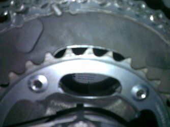

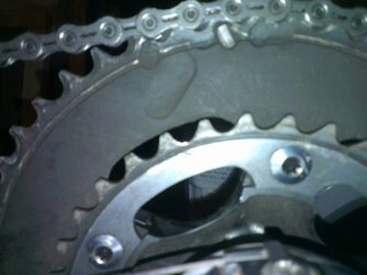

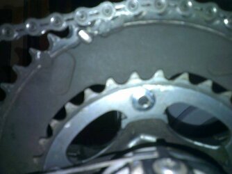

Anyone got an opinion on the state of the inner chainring?

Also my inner chain ring is a 'sg-x 9s/ 10s 34-f'. No idea what these numbers mean...
Can anyone recommend a replacement so I can price one up?
That inner chainring is worn, it's getting the classic shark fin profile. You will need to know the BCD [bolt circle diameter] to get the right one to match yours as there are several. Once you have that it's a fairly simple job to change it and there is plenty of choice out there. The 34 indicates a 34 tooth inner, typical of a compact chainset.
