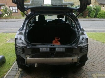

^^ after removing the bumper cover you have to remove this alu bar

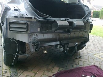

Then replace it with the bar..

As already stated - fitting the tow bar is easy.... sometimes need to remove the rear bumper, but then it is usually just 5 or 6 bolts.
The electrics may be more difficult depending on the car wiring. I have fitted a good few tow bars over the last 15 years.
