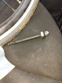

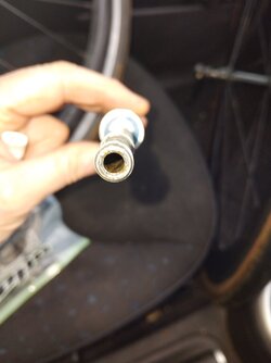

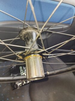

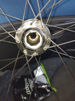

Trying to service a mates freehub anyone know how to get this one off , it's got cartridge bearings but no idea on make I've got the axel and and the bearing dust cover etc out

Marchrider
10mm allen key ?
fossyant
Ride It Like You Stole It!
South Manchester
Other option is you need a 11mm or 12mm hex from the non drive side (i.e. stick the hex key in from the other side), but, what's the axel size ?
What make is the hub, any numbers printed on it ?
chriswoody
Northern Germany
Looks like a 12mm thru axle in the middle? in which case it could well be a 15mm hex key you need, I've the same on my Mountain bike hub.
