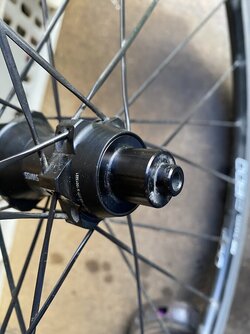

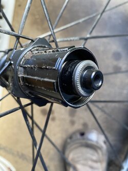

Hi everyone,
l’ve looked at other posts on this subject, but can’t see any with a similar freehub assembly to mine. Please see attached photos. The wheel is a DT Swiss and I think the freehub is an 11 speed Shimano. On removal of the cassette, I can’t see any means of removing the freehub. There are no hex keys within the axle, only a serated shiny metal ring sat on the outside of the freehub. When you turn that, the whole axle turns on the non drive side. Looks like the non drive side needs to be held solid, allowing that notched ring to be undone with a special tool?Anyone familiar with this set up please.
Many thanks.

Looks like they’ve already removed the axle in the video. That’s the bit that’s causing me problems. How to get that silver coloured toothed ring off?

If you spin the axle from the non drive side, does that silver washer thing spin with the axle?
Or if you spin the freehub does the washer spin?
