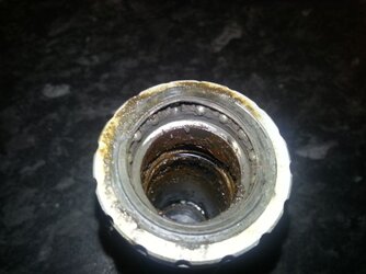

Narfuk
Off my friend's 2011 Dalesman - so completed about 3k......
I have given him a lecture on caring for his bike!

I've had 2 Deore ones both go in about 2k miles. I have one of the next up in the Shimano range (SLX or XT) on my tourer and it's lasted 5k miles and still going. All my BBs are faced and I'm careful not to overtighten the cap.
When they start devoloping play I've often got a good few hundred miles out of them till it starts bugging me too much, so it's not the end of the world if it happens on tour, but not great either.
