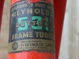

Just out of interest what leads you to believe the frame is 531 ?
It looks quite basic and [I hope I'm wrong] but I've noticed a few frames appearing with 531 labels on them But a double butted 531 frame was [as you know] always quite a catch. Anyhow, as I said I hope I'm wrong. Good luck with the bolts.
As a complete novice I was purely going off of the sticker :blush: The guy I got it from seemed to think it was a good frame and muttered something about the hubs. The frame does seem really light - but I know you can't tell by that alone.

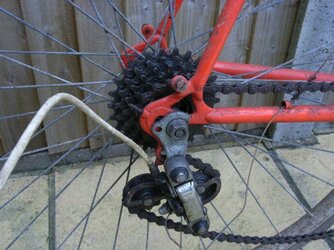

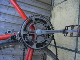

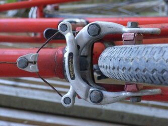

The bike looks a bit of a "bitsa". The front wheel is proably not original and the suicide levers don't belong on a quality machine but the threaded rear drop outs are indicative of a good frame. Does it have 531 transfers? It doesn't have a model name on it which is also a bit strange if it is towards the better end of the Raleigh range. It may have been resprayed. The pedals and plastic down shifters indicate lower end model.
Thanks. Took these before I took the bike apart. Don't know if they help any.

TBH the 531 badge does look original and the weinman calipers were a good fitment in the day so thankfully you may right about the frame:smile:. As for the coating / painting try checking out the motorcycle press. Both custom and vintage / classic bike. These places are often more used to dealing with 'smaller' [and more delicate] bits and tend to understand more about blanking off screw threads etc.
Cheers have found the frame number, though a couple of the digits are hard to identify. I think it reads WE 0806428, which from the Sheldon Brown suggests its a Worksop frame and I'm guessing 1980. There's also a F&S stamped across the frame numbers heading in the opposite direction. Any ideas what they mean as I can't see any reference to them on Sheldon's site.

The style of Reynolds badge would seem to indicate from the mid seventies onwards so 1980 might well be feasible. The rear derailleur is not original as it would have had been mounted on the dropout hanger and is a low end model. Shame there is no reference to the model name. From your pics it doesn't look like it has been resprayed.
