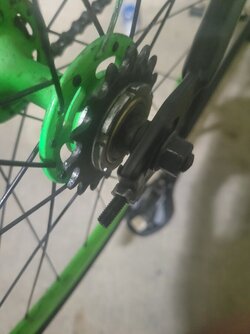

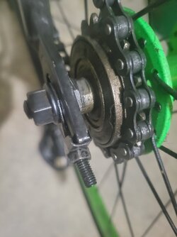

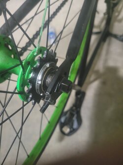

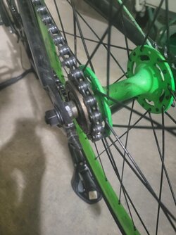

Hey guys I am a beginner when it comes to working on bikes, so I'm sorry for this extreme amateur question. I just picked up this pure cycles fixie and decided to try my best at flip flopping the hub so I didn't have to constantly pedal. I managed to get it but I'm not sure if I put everything back on right. There seems to be a slight noise that sounds kind of like the shuffling of a deck of cards when I try to pedal it with the bike turned upside down. Riding it feels fine. Also the thing that the chain is attached to is wobbling a little bit (I don't know what it's called) also now that I look at it it looks like the chain is kind of moving up and down.
I'm just going to post some pictures and hopefully someone can tell me if it looks like I reinstalled everything right. Thank you so so much

Did you tension the chain correctly after reinstalling the wheel? Watch this video from 4:13
View: https://www.youtube.com/watch?v=88tDcVvS7mU&ab_channel=ParkTool
