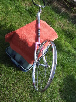

Hi guy's, this is the first post in this, my first attempt at a thread.
Hopefully the photo's are self explanatory.
This is an intuitive attempt at making a practical shopping type mono-wheel trailer using 99% available materials.
Happy to answer any questions.

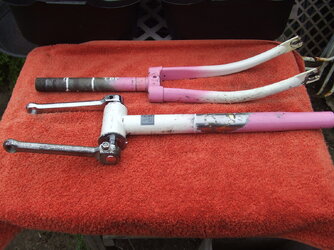

The donor bikes were KP-18's, junior versions of the venerable 'Kingpin'.
These came from recent purchase of a stash of 7 'cycles, 4 of which are Raleigh 'Twenties', the pick of the crop is a 'mint' 1978 'Shopper', which is the one I was after but the vendor wouldn't split the bundle. The other 'Twenties' are BSA and Triumph versions.
The fourth one is a later U-framed version.
Not one folder among them.
Instant collector LOL.

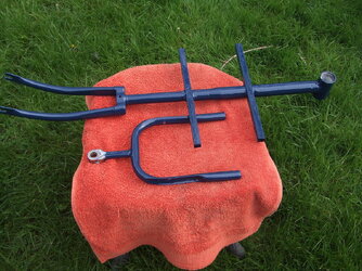

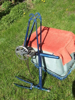

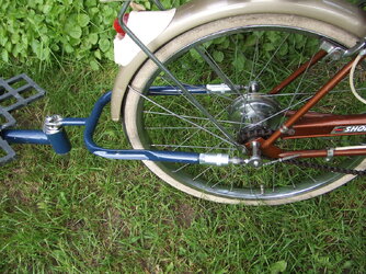

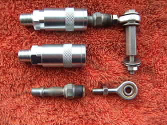

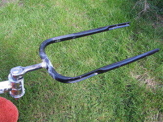

The towing 'cycle is connected via the black end, the round thing at the at the other end is of course the rear.

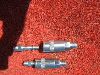

Still waiting for some hemi joints which will be attached to the 'cycle drop outs, in turn attached via the pneumatic fittings to the forward ends of the prongs of the black member, and provide a quick release of the entire thing.
That will give vertical pivot for the whole shebang.
The b/b joint allows horizontal movement,

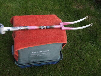

The 'spine' is waiting for 2 cross members which will have the bottom of a plastic bread basket as a bed for the 'box' element fitted to and finishing assembly.
These first detail allow me to assess the levels, from which progress can continue.
I've walked it around the garden and it does work.
Additional length is about 2/3rds of the cycle its self.
I'm delighted to say, I'm on target with 'PLAN A'
Thanks for your interest.

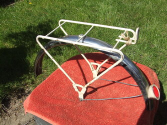

Project bogged down waiting on delivery of hemi joints, so I 'm making a couple of front rack/carriers, by adapting some old rear ones.

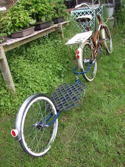

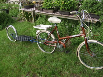

All components coming together.
The 'boom' to cycle drop-out fittings have been modified.
The 'boom' is modified with ribs to take a platform and painted. The paint (smooth Hammerite garage paint) is taking for ever to dry. Once it is, final assembly can be completed.
Posting these photo's to keep the thread alive.
K
KoffMixtures
South Yorkshire

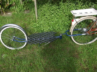

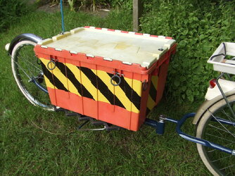

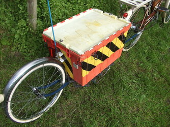

After a long wait (for paint to dry) .... here it is!
Hitch = 1.5lbs Trailer = 2.5lbs Box = 3lbs Total 8lbs. Bike = 5 feet Trailer 3' 10'' = 8' 10''
Cost; about £20, mainly for the pressure fittings. These allow the trailer to be transferred to another bike, which will have its own connections..
