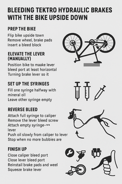

Right - my bleed kit has arrived. I've never done this before so I asked ChatGPT for advice given I've no bike stand at the moment.
This will be fine, right? As long as the missing instructions aren't important, and I look out for bubbies?

Don't flip the bike upside down, that will cause any air to rise to the caliper rather than the master cyclinder where it needs to be - this will make bleeding much harder as you'll struggle to get air out of the caliper as it has a tendency to get trapped.
If you're only doing the front wheel, you can take the wheel out, rest the forks on a towel (helps with spillage anyway) and put the bleed block in. Lift the handle bars so that the bleed port is parallel to the ground (it may be easier to rotate the handlebars to do this). Then bleed the brakes.
Do you have a bleed cup or is it a pair of syringes?

I wouldn't rely on GPT! Did the kit not come with instructions?
Here are Tektro's instructions
And these are the ones that come with the kit from Epic Bleed Solutions (I've still to get round to bleeding the Tektro brakes on my hybrid)
Or, in fact, why not ask Cyclechat? We'd give you a load of conflicting information and then have a huge argument about whether disc brakes are any good.
Maybe not as useful as a set of instructions, but more entertaining.
