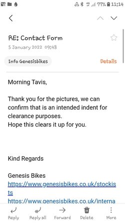

Dent in seatstay
How would the dent have happened anyway - there on the inside of a tube ? ? Definitely looks like a design feature to me.

I guess its a function of straight stays and an 11 spd cassette. Alu or carbon stays are normally shaped to accommodate the width. I guess a careful kink keeps the outside looking neat.

Just as an aside I once squashed an 11-32 8sp cassette into an old 1980s frame. I had to run it as 7s because the teeny tiny 11t sprocket caused the chain to foul the frame.
Nobody in his right mind designs something that looks like a dent. My guess is that they got the frame measurement wrong and had to do that across the stock that has already been manufactured. It is actually a lovely bike and the brand is well regarded.

Chainstays tend to look a bit dented next to the chainrings.
That said, your guess could be right.

This email from genesis clears it up I bet there's a lot of people out there who might have thrown there bike out thinking the frame was scrap
