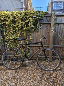

@chriswoody My father recently passed away and he had the same Clark Kent bike as yours albeit with a different spec. His was given to him by a German friend who bought it from Keha Sport and then took it with to South Africa. It was built with STX RC components and a flat bar. It has Ritchey rims and tyres and Clark Kent branded bar, stem and seatpost.
Did you find anything more about the frame? Do you know what the bracket on the left side seat stay is for? The copper collar on the seat tube of mine is stamped with the S/N HFID0158

The bracket on the seatstay is almost certainly for a rim dynamo. It looks to be in the correct location for a rim dynamo. For quite a few years, Germany required dynamo lights fitted to new bikes, unless they were designed for racing.
The bolt near the BB on the OP’s bike originally would have had a pulley wheel fitted to it to redirect the front derailleur cable without adding friction.

As for the bracket on the seat stay, @LittleWheelsandBig is correct, it's a bracket for a bottle dynamo.
