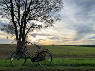

I too have a Sovereign Princess. Lovely bike, although a tad heavy but she rides wonderfully. Yours is indeed the Sovereign model as it has the skirt guard, the seat stay lock, hand painted good trim and the stand, these were all optional on the lower models. I simply added a battery rack light on the rear and it has been more than adequate. I upgraded the front light to a Lumotec classic which gives a good beam and doesn't dazzle oncoming riders.

Thanks for the responses everyone, that's a lovely photo @gizmo1994, and thanks for the postive ID.
