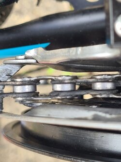

Basically I'm having a bit of chain rub & wondering how you sort it?
Only really noticed it after a bad gear change which was a little jammy/crunchy & since that it's only really noticeable in 2&7. Not sure what you guys call it but to me that's gear num 2 up front & 7 on the rear. Might happen in other gears but not noticeable like it is when set on 2&7.

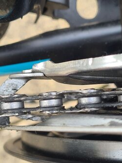

See how that's fairly close.
Pedal on a bit and a gap opens up....
Which is in line with what can be heard - in that it's like a grasshopper sound every so often.

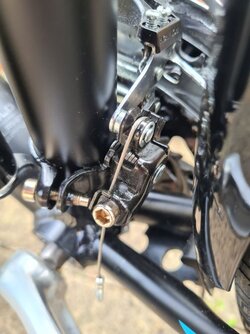

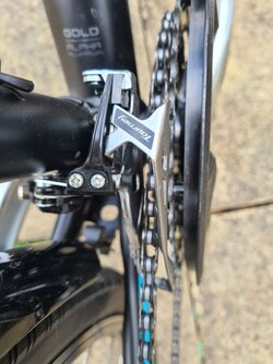

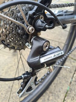

Now as I have a funny feeling any adjustment advice is going to include lingo that will have me posting back saying what's that, I come equipped with more photos :biggrin: ....
That's anything I can see in & about that area that may be linked to adjustment.
Just not sure how to alter it so that the chain rotates smooth/straight instead of going in & out as it must in order to be hitting off that (guard?).

If the chain moves in and out in one of the chainrings, then you've bent the ring. You might be able to straighten it sufficiently to make it work silently. Some ingenuity required if you don't want to or can't remove the rings.
That's what I was wondering.
With what they were talking about in the videos, I would imagine that there's a constant rub and no just at various points along the line.
Would a dodgy gear change bend the ring? To be honest I'm not 100% on what lead up to it. At the point I started noticing rubbing I tried thinking if anything wrong had happened recent. I think I was in too high a gear for what I was doing & started changing down but it wasn't smooth.

It can only be slightly out of true. An alternative explanation is that it was always out of true and that you have slightly bent the cage of the front mech. Check whether the outer plate is parallel with the big chain. If it's not, it's usually possible to bend them back by hand.

Everything looks straight to me. Though to be fair, with as much as it's coming in & then going back out, it's only a little bit, so anything that isn't right is only going to be a little bit not right & therefore to the know-nothing - difficult to spot.

1) This is front derailleur stuff (don't worry about rear/sprockets).
2) If your chain is oscillating laterally as the cranks are turned then either you have a bent chain ring as @Ian H has said, or one or more chain ring bolts (of five or four) are loose, or (v unlikely) spindle is off. Needs sorting.
3) This is occurring middle ring of triple. Not a 'limit screw issue'. Need to get the cable tension right (see videos above) In the inner ring and largest sprocket max 1mm gap to inner cage plate and zero cable slack (even v slight tension) (with shifter in '1').
It's a brave person who says they've mastered FD adjustment and with no screw adjustment (unless installed as an 'extra') tweaking is not as 'easy' as RD fettling.
