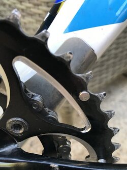

I think these chainrings are good for a while yet ?

Absolutely, no way near worn imvho
Paulus
Barnet,
As above, they still have a while To go yet.
What's your plan for them?
Punkawallah
While not wishing to rain on a parade, I was told that if the teeth look like shark’s fins, they are gone?
Jenkins
Felixstowe
Worn (about 9,000 miles) but still useable on the left, new on the right.

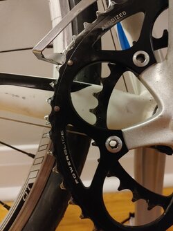

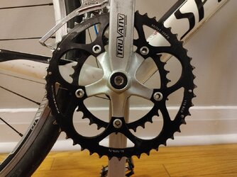

Novice with a similar question. I purchased a used Specialized Allez a few week back that has 1% chain wear. I just replaced the chain and cassette, but am wondering if I need to change the chain rings as well.
