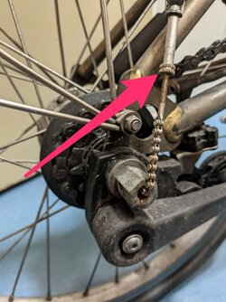

so some time back, a bike shop guy fixed the above issue simply by turning that little wheel, shown in the attached picture.
question: which way to I turn: towards the front or the back of the bike?
many thanks!

Mark it and then try both ways. One will shorten and the other will lengthen. See which one works.

If you get it right but have to undo to fix a puncture. You’ll find the correct position is the line between dirty and clean threads
There is usually a window in the Axel nut and a line on the linkage that should appear there in the middle gear. That’s if old school sturmey archery.
oldwheels
Isle of Mull
Surely you line up the end of the rod with the hub in middle gear to get the correct position in old school SA 3 speed?
Not expressed that very well but there should be a window in the AXLE nut to see the position. The nut the OP refers to is just a lock nut to secure the correct setting.
I think there is a window visible, arrowed

I had to get different axle nuts to take a BoB trailer which had no window to line up the operating rod but the normal ones do have a window to let you see the chain and rod.
The OP I think is referring to the locking nut for the chain/cable connection.
