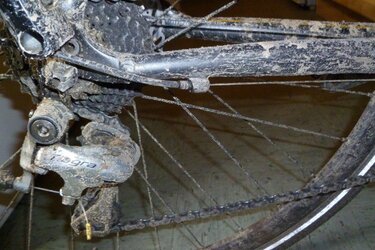

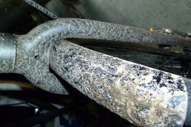

Btw, is there a cleanliness standard for the ride? Will I have to clean my bike for it? :tongue:
