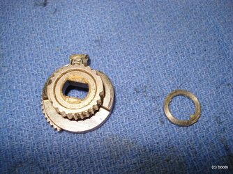

The clicking in those shifters involves a cog/ratchet with teeth (see small drum of teeth at bottom).
On either side of this cog are two little black "springs"
The inner bits of these two springs fit in the gap between the teeth of the cog. So the cog is held in place by the two springs.
The drum with the cable is attached to this cog so if the cog moves the cable moves.
Basically all the rest of the mechanism does is turn the central cog - the two springs are then forced over the tooth and down into the next gap.
This causes the click (actually two clicks!) - both ways.
You will therefore appreciate that the shifters work on brute force - the cog moves forcing the springs out until they drop into the next gap.
This wears both the teeth of the cog (slightly)and the springs (more so)- so over time the "clicks" become less audible and the shifting a lot smoother but slightly vague .
personally I love the shifters when they are at this stage - but of you want to get back to the crisp and noisy clicks then you need to renew the two black springs. The ratchet will cost more than a new shifter!
It is a fiddly job to take apart. You will need to take the lever off!!!!
