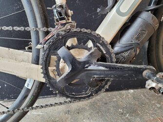

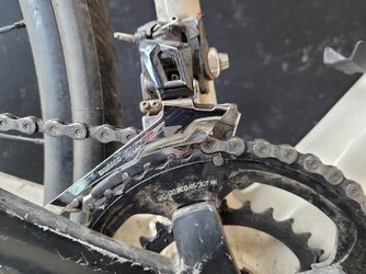

Braze-on R7000 105 mech with a 46/30 chainset
Must have far greater range of adjustment than mine, then. Mine might - and I mean might - manage a 48...
Having said that, as I type, I'm remembering that I've just fitted a more modern mech, max chainring 50t. So if it were a double, it would just make a 46.
I'm cheating talking about this anyhow, as I run a triple! So 50-39-28 at the mo...
