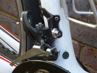

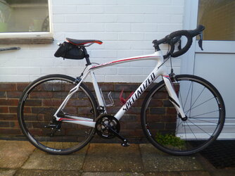

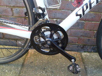

That's the conclusion I came to when I wanted to lower the gearing on my Roubaix in advance of a cycling holiday in the Pyrenees. I had a SPA sub compact 46/30 chainwheel in my parts bin, so it was just a case of swopping over a square taper BB ( luckily the Roubaix has a threaded BB rather than press-fit) and tinkering with the derailleur height, which turned out had to be at it's lowest possible allowed by the mounting. I also fitted a 34T cassette. It's all worked well, fears of spinning out on 46/11 haven't really materialised , but that could be a problem for stronger riders. An unexpected bonus is that I find I stay in the big ring much more when cycling locally, which is rolling downland countryside. A slight downside is that the SPA set up isn't the prettiest , being essentially a triple minus the outer ring- however I wouldn't go back. a couple of photos.
