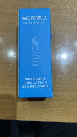

Bought three "Race Formula" TPU tubes from Amazon last week. Replaced my Latex tubes on my "best" bike with Challenge Strada tyres. Easy to fit and two 50 Kms rides so far all seems well. I'm no Remco or Jonas so I can't say they are fast or slow (can anyone?)
They do however hold pressure better than Latex.
