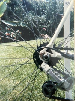

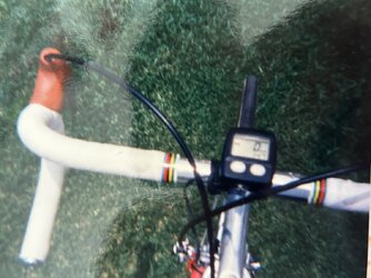

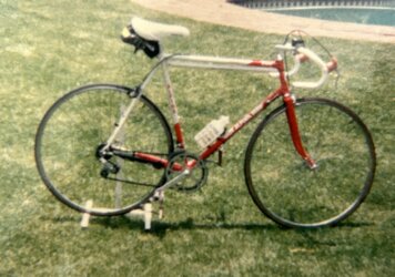

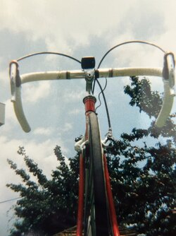

I owned an Alpina in the late 80’s as a teenager. It was a reputable brand back then for road racing. I’ll try dig up some photos of mine in the coming days

Looks nice - love the colour and it's interesting that it looks unlugged given it's apparant age.
FWIW I'd recommend flattening out the saddle and rotating the bars down a fair bit at the front so that the levers are ballpart vertical - this will reduce reach and improve ergonomics as I can't imagine operating the levers is much fun currently!
