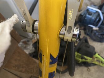

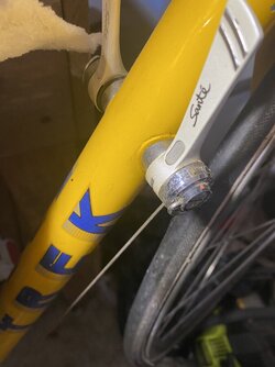

Thanks for the response but not sure what band-on or braze-on is. I’ll include a pic if that helps. Also, my rear frame width, drop downs, is 126mm. A friend said he could cold-set to increase to 130mm.

That's a braze on boss fitting as I expected. Shouldn't have any problems finding a shifter for your new set up.
The problem you're going to have is fitting a wider 9-10 speed hub into your existing frame which I suspect is not wide enough. If you had a steel frame it's not a problem as you can cold set it but you can't do that with aluminium so you might be stuck with 7 speed.
If you want more speeds you could always consider a triple up front.

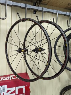

Purchased these from a coworker which he said wouldn’t work with my current setup. He said he could cold set my rear from 126mm to 130mm. I’ll give an update. After reading these responses doesn’t sound possible and still maintain frame integrity.

si_c
Wirral
He probably assumed that it is a steel frame, which you can cold set. You can probably sell these on if needs be, but I'd advise against using them in your frame.

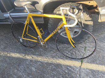

Cold-set finished. The future will determine if frame integrity has been compromised. Next step is installing a dura ace 10-speed component set, including downtube shifters, from the existing sante 7-speed. Tires, bar tape, pedals, and seat too.
