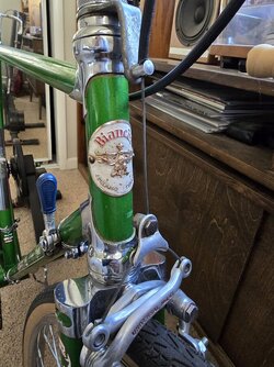

The frame is a really interesting mix: the chromed ends and lugs are really nice. The headbadge looks like the rare, mid-60s spread eagle on a cream background:

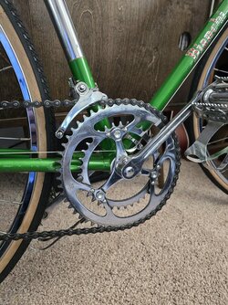

The headset and cottered cranks are suitably 60s (side note: try to find a suitable pin spanner to adjust the headset, don't resort to plumber's or stilson wrench!) while on the other hand the rear dropouts look pressed rather than forged and the seatstay caps are quite abrupt? So it's a mid-range mix of really nice features with a bit of cost-saving thrown in, which, again fits with built-to-order spec.

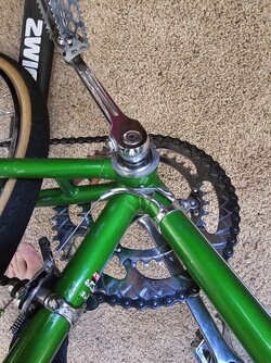

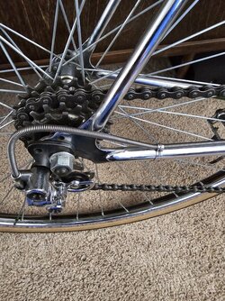

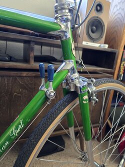

Thank you for the indepth reply, this is extremely helpful. I am already on the pin spanner. I saw a blog recently on how to modify a parktool version for use.

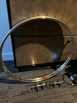

I have some amateur phots to upload. Sorry for the odd angles - dog, mirrors and work all played a part.

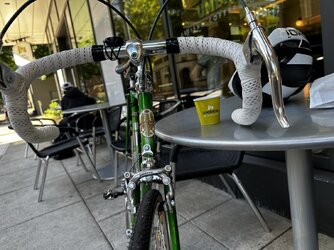

In terms of the stem - I think it must be replaced for me to ride. At this moment I think a 110cm 3T granprix seem appropriate in age and I believe was on up model frames. I am open to discussion on that. Since the tape is coming off I think it is going to be cloth down-wrapped (I know) and shellacked. I have some vintage finishing tape but want shellac and direction over twine or finishing tape. Again, open to suggestion. I see on a few other bikes the retaining bolt for the rear tire to have been chrome and had a ring of sorts - I have no idea what that would be called but curious if that would also be a good add.

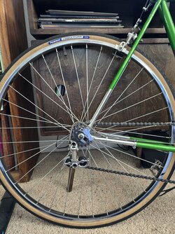

Id love to understand what is not stock on the bike. My understanding from the original owner is that the initial rear derailer was a simplex which I have (Brevet6 Prestige-Simplex). The quill is not stock. I believe (guess) that it original came with a hand stamped TTT quill similar to the supr'.

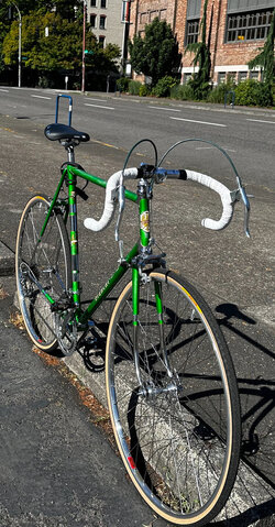

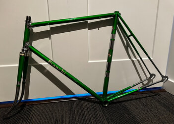

Bought this Gran Sport frame on Ebay. Built it up over the winter. Pretty close I hope. Wondering what year it was built. Serial: 162363

Thank you. Work in progress. Rides like a dream. Comfortable.
