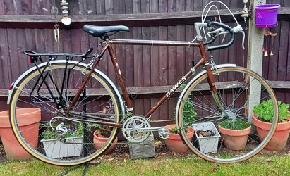

Apart from a saddle change and shakedown ride it's finished at last.

I couldn't get the Dawes to shift properly. Found out the rear derailleur hanger was bent. Took it to a local bike mechanic who straightened it.
I've changed the saddle, replaced the plastic cable clips with period correct stainless steel ones. Fitted a new tan wall tyre. I think that's it finished now. I've taken it for a short test ride it seems okay, although I haven't ridden drop bars and down tube shifters for 40 years. I'm not sure about them but hopefully I'll get use to them.

Nice bike,
I had one of those saddles on my 1987 Galaxy, and I found it very comfortable.
What is the name/maker of the saddle ? I can't make it out from the pic.
Just in case I can find another.

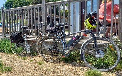

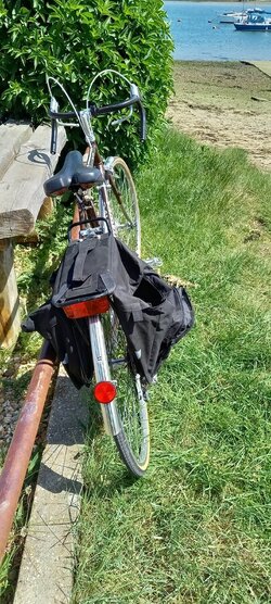

Had a fairly decent ride on the Galaxy yesterday. As I said earlier I haven't ridden a bike with drops, non indexed gears and down tube shifters for since a teenager! Soon got use to it and the bike rode superbly. It felt light and responsive, shifting was smooth. It was a joy to ride.
I was worried about it being too big and not finding it comfortable but it wasn't a problem. It's definitely a keeper.
Excellent :smile:
The frame does look a little large from the saddle position, however maybe you just have a higher upper body to leg ratio.. regardless if you're comfortable that's all that matters.
Always rewarding to make use of / enjoy riding something you've put a lot of time into - good work!
