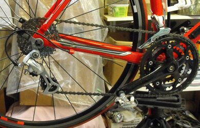

Now this thread is the nearest I can find to my problem I changed my 8 speed 11-28 sprocket cassette to a 9 speed 11-30 cassette but am finding that the chain is skipping when pedaling in the 50 chainwheel and 11 cassettee sprocket. Though the R D is a sora the set up worked fine with a 8speed 11-28 cassette and the 50-39-30 chainwheel to get the 11-30 9 speed to work I put new 9 speed chain on and using the chain caluculotor? (the thing that tells you how longer chain you want) it told me 55 links but could not get the set up right till i'd Reversed the B screw as the jockey wheel was catching the 30 sprocket when on the 30 chainwheel (this is a bail out gear as never yet used it on road test) and I've realiesed that the more you wind in the b screw it pases the point of contact on the Derailleuer hanger this is when you've got a longer 4mm screw as the exsisting one is too short! So I now think the derailleuer mec on the rear needs a bigger throw, Longer derailleuer body more expense and I thought I'd cracked it might have been easly to leave it as wrapping the handlebar tape was a
Trauma in itself! Perhaps I need a longer cage Rear Derailleuer Though Its only 2 teeth bigger it must just be to big.
How many links should my cassette Sprocket be engaging at any given time and is this the reason for the skipping !

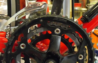

I mean it works but with these little annoying side effects though looking at 50 chainwheel that looks a bit worn as its done nearly 4000 miles this year (would this wear out this quick?) and lets face it the whole bike was only £300 new though after having done quite a few mods its more like £500 now.

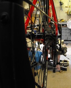

The main problem is the chain skip and if back pedaling more than half a revolution when on the 50 chainwheel and any cassette sprocket the chain comes off the chainwheel looking at the set up from the back it looks as though the jockey cage slopes inward toward the wheel. by about 2mm at the bottom. though never had any falls on to the ground that would have bent this. Is there any fixing thats adjustable between the bottom of the Derailleuer and the top of the jockey cage housing that might be loose; I can't see any fixing for this assembly at first glance!

There is a possibility that the mech hanger is not only bent from vertical, but also twisted in the vertical axis (which you might be able to spot if you look at the mech cage from above when the bike is upside down).
One easy way to checking hanger alignment is to use a rear wheel, but only if the wheel has a M10x1mm threaded axle (which e.g. most rear hubs made by Shimano have), because the hanger has the same thread. This is however not without some risk (of damaging/weakening the hanger).
What exactly happens when the chain skips when you are on 50x11?
Hi. When the chain skips I'm going down a slight slope most people would be happy to coast I'm trying to get just enough speed to go up the next slight incline without changing down, Its as though its jumping perhaps a couple of teeth on the 11 sprocket on the cassette I can't say I've seen it do it but thats what it feels like! What I will do is take a photo of the rear mech when the chain is on the 11 sprocket and 50 chainwheel and post it up on this page though have to wait till tomorrow now as too dark and wet out there at the moment .

Can you post some pics?
Here are some pics showing chain on 30 sprocket and 50 chainwheel for lenght and the second pic is of state of 50 chainwheel (which I wondered is this worn out yet) though wouldn't be cause of chain skip?
And lastly view of rear mech hanger when chain on 50 chainwheel and 11 sprocket I can see it looks to be lent toward the wheel but is this partly the angle of the picture as can't get directly behind as don't want to fiddle with mudgard
