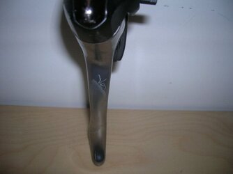

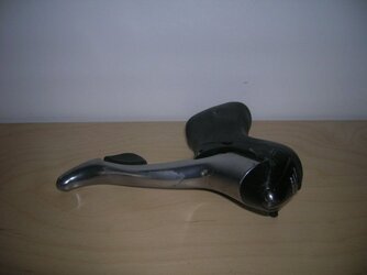

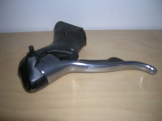

Here's the pictures. I've tried to show all the marks. As I said it works fine just cosmetic damage.
