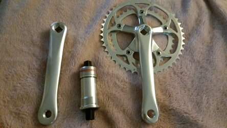

I've bought a First Components BB from Spa along with a new square taper crankset. Beautifully shiny. Bare metal is Ti. It won't be a problem.

Nice, very nice. Would match the Chris King headset on the bike, which is a top bit of kit.
