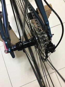

Guys my brand-less rear hub is wearing off. Which brand and model of hub can I use without having to replace the spokes.
This is my wheel setup:
- 700x28C
- v-brakes
- 9 speed
- 135 o.l.d
- 24 holes
Thanks

First of all, what is the problem with the hub?
Are the bearings a bit slack, they can be greased and reassembled.
Is the freehub making a noise or sticky.
Or do you want a named hub?
A little more information would be helpful.
PedallingNowhereSlowly
As above, you need to be a bit more specific about what the issue is. Is the wheel loose/wobbly? Is the hub grinding when the wheel is turned? Is the freehub not engaging or not disengaging, so you have problems freewheeling or pulling away? (freehubs can usually be replaced separately)
Hard to say from that picture, but that hub looks like it might accept cartidge bearings.
A new set of bearings and it will be as good as new. I've never actually had to replace a set of cartridge bearings, but I imagine some disassembly of the hub will be with required in order to find a stamped part number or careful measurement with a vernier gauge.

Hi guys. Thanks for your time. The hub doesn’t spin as smoothly as before when it was new. Perhaps it’s just a feeling. Very little grinding noise. Sometimes it gives off a squeaky sound after I’d sprayed water on it. I’ve stop that stupid habit anyway. It’s 6 months old and I did about 2500 km on it. I thought if I changed to a better hub (like the DT Swiss 350), I can save some effort pedalling. Perhaps go a little faster. The problem is cost. It’s too expensive for me and I can’t find an affordable Shimano hub that can fit.
Ajax Bay
East Devon
You need to get right size (obv) genuine bearings eg SKF and replace. As effective, quicker and way less expensive.
Big John
For no cost, or at least very little, you can get that hub working smoothly. It all depends on how mechanically minded you are. I certainly wouldn't be thinking of getting another. If it's only six months old it's only got about another 40 years life left in it lol.

Thks guys. I think I’ll keep the hub. It’s still in working condition. I think I’ve been carried away by some website that say a good hub will make you go a lot faster and with much less effort put in. Anyway my bike is an old Trek FX1 modified with some basic road bike components. Too expensive a hub may not be compatible. Pls correct me if I am wrong.
Paulus
Barnet,
You are not wrong.
Just clean out the bearings and hubs, re grease and re assemble. They will run perfectly well. Plenty of advice on how to do this task on YouTube if you need it.
