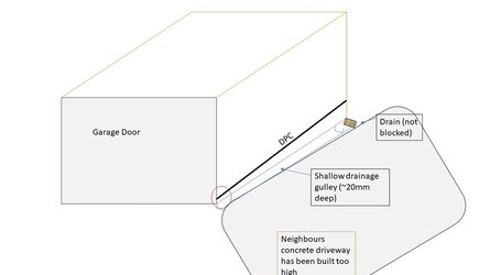

Thanks for your time. I can't get a photo yet, but I have done a crude Powerpoint slide of the garage. I'm pretty certain that the water gulley is not deep enough to accomodate heavy rainwater, so it pools up and enters through the DPC at the front of the garage before it has chance to run away. The slope is very shallow. It runs in and down behind the plasterboard to the back of the garage, as the slope is approx 10mm lower at the back. It then can't get out, so pools up and has moulded up the plasterboard.
Would cutting the gulley deeper with a large angle grinder do any good? I'm thinking a series of 1/4 inch deep cuts with a fairly wide concrete disc?

The DPC is a red herring. It's there to prevent rising damp getting to the bricks above the DPC. Much more important is the relationship of the external ground level and the floor inside. The latter should be above the former, and if it's not there is a clear route through the wall for moisture. However, none of that may be the problem, or the answer. A splash from a leaking gutter is plenty enough to have damp enter a solid masonry construction. Or a dripping tap. A build up of moss. Without photos or a site visit, I don't think I can say any more.
