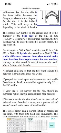

I refer you to Sheldon:
Ajax Bay
The charts posted upthread are good for understanding the safe range of tyre widths. But, they don’t tell you the optimum width for comfort or wheel protection.
As @rogerzilla posted, 1.5-1.75 x inner rim width is a the sweet spot.
Where do you get 1.5-1.75 from Sheldon, whom I referenced in post #3 btw?
Whatever, Sheldon offers a decent range "A general guideline is that the tire width should be between 1.45/2.0 x the inner rim width.", not a "sweet spot".
