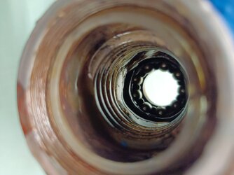

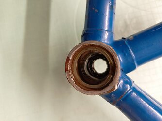

Been filling it with WD40 and hitting the wrench for the last two weeks, not moving.

If you pull out the plastic sleeve the cage bearings should come out.

They should fall out including the cage

I did and they're out👍🏽
I'll try the bolt trick later.
