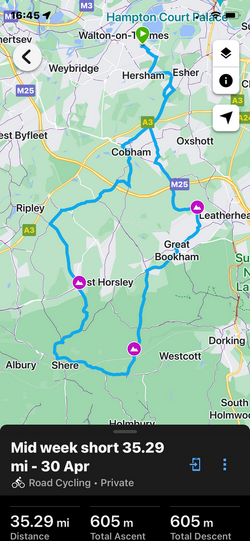

Use your Garmin app, click on courses and load up a course.
You will see the little hills on the map. Click the hill in question and it will open up to tell you all you would like to know 👍

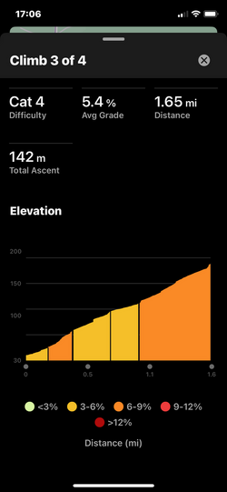

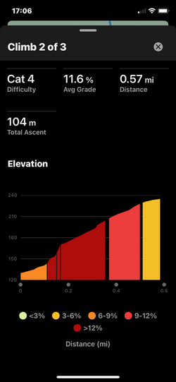

These two are both Garmin cat 4, I’ve been up both, the first left photo is considerably easier 🤣
