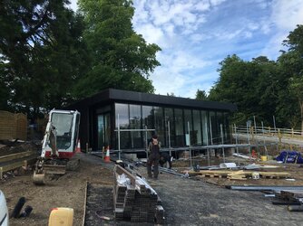

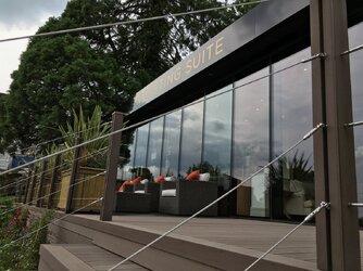

I've used it many times in commercial applications, but we use a galvanised steel subframe rather than timber for all the reasons mentioned above. First project was 8 years ago and is still going strong. Darker colours seem to bleach a bit, but that's the natural beauty of composite!
It's certainly more expensive, but when you consider the lack of hassle and the low maintenance over its lifetime (which with a steel frame should also be greater than the timber equivalent) it starts to even out.
