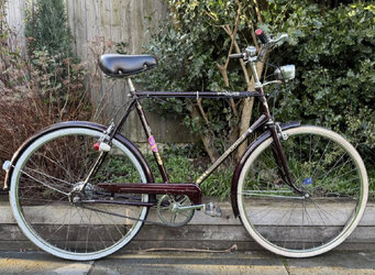

This is the bike as shown on eBay - I’ve not taken my own pictures yet.
An ideal middle-aged-commute kind of bike.
