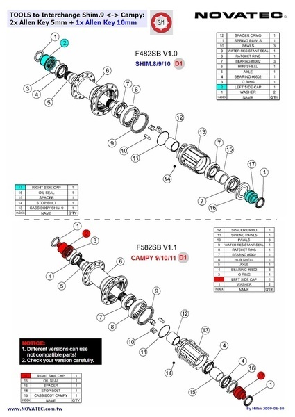

Paul there are numerous designs, but the basic principle is given near the bottom of this link. Many freehubs require a 10mm hex key to remove/install. I am tempted to say usually no special tool is required but it is impossible to be sure. To give you some idea of what was discussed some example exploded diagrams are here and here.
